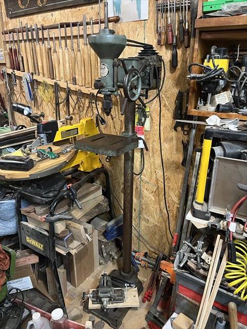

Purchased from third generation owner in rural eastern Pennsylvania. Very limited production run of this design, it was only offered for a year or so. This particular machine was in excellent condition without any damage or idiot holes, just surface rust and grime. The exposed metal has a deep, dark patina. The painted surfaces are generally in great shape. The are several interesting features not found on later models. The post is 2 1/2” in diameter, not 2 3/4”. The “ship wheel” feed lever is unique. The depth stop is easy to adjust(thumbscrew). The table is angle adjustable and locks at the post from the side instead of underneath. The quill lock is a screw with a locknut. The original motor is a Walker-Turner DeLuxe Dl10 1/3hp. Even the power cable and plug are in great condition and original.
D921

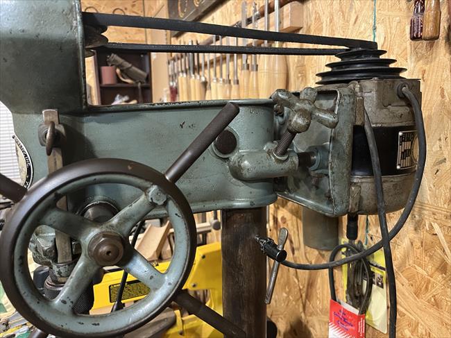

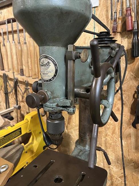

The wheel,depth stop, and quill lock

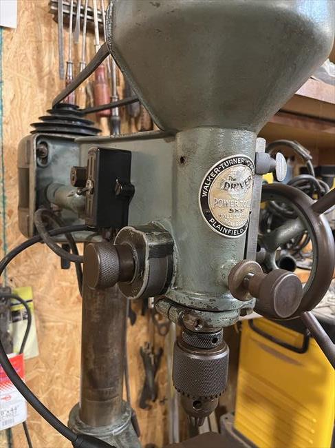

Repainted switch. Paint and oil, and belt are the only new things.
