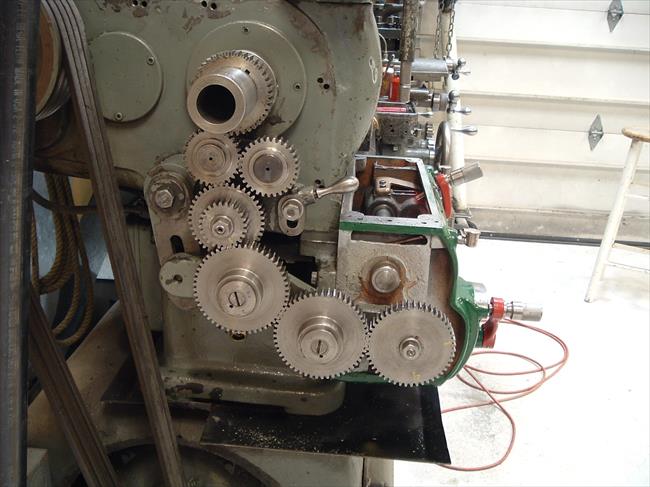

A final note on the Lathe; it appeared to have not been lubricated for the last many years of its working life; all the plain bearings were dry and filled with a black dust and the ways were likewise dry. The headstock lubricant had probably never been changed; there was 1 inch of thick goo piled on the horizontal shifting bars in the headstock. The nose was horribly pitted from years of installing chucks without first wiping the chips from the nose socket. In spite of the terrible lack of maintenance, it still was possible to bring it back to good working order; a stout machine, to say the least.

Geartrain to the quickchange.
