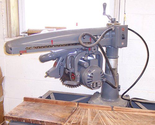

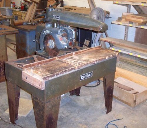

I had the saw in my shop for two or three months before I could start on it. The base, as you can see in the photo was very rusty. I built a temporary tank out of concrete blocks on my trailer and lined it with plastic sheeting for an electrolysis tank. I cleaned the base in tank and used a smaller tub for the legs. The rest of the saw was sanded and/or wire brushed and repainted. I chose to keep the original table as a connection to it's previous owner.
The saw was originally a very dark gray from what I found under the switch box. Since I plan on using the saw I didn't worry about making it perfect and just used this lighter gray I found. The saw was in excellent shape and just needed years of dirt cleaned from it and of course the rust from storage. It even has the (as far as I can tell) original Arrow Hart switch on it. The only thing left to do is reinstall the DeWalt tag on the base and enjoy using it!
This was taken just after I unloaded the saw from the trailer

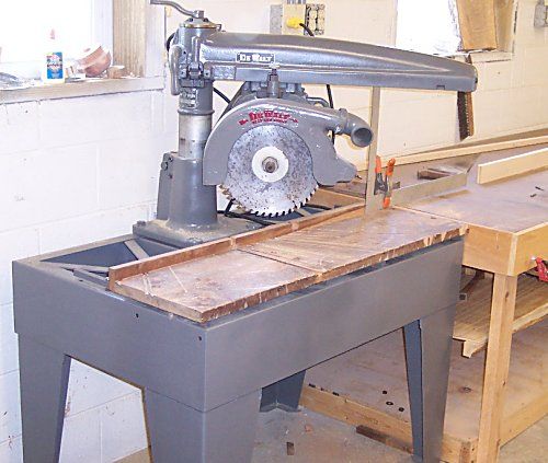

The saw as it was being installed in my shop
