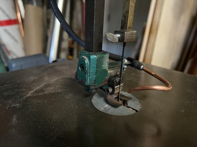

Retired from school shop in Orem, Utah, Craigslist find in Twin Falls, Idaho in 2019. The chucks and blade guides on these are wear parts that tend to be worn or wallowed out, but replacements are no longer available. That was true here. You can make new chucks and you can squeeze a little more life from the blade guide by grinding it back 1/4 to 3/8-inch and then sliding the assembly forward in its carrier -- that will buy you another decade or so. The chip blower is also usually missing and difficult to find. The hardware bin at ACE will get you going, it's low budget and ugly but functional. See photos.
