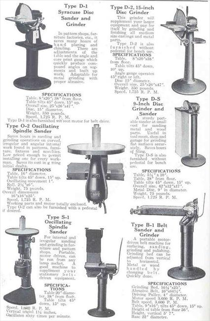

Purchased 10/16/2022 at a living estate sale along with a Baldor grinder and Delta 14" drill press. Unknown to me at the time that the only evidence of these existing as this model number was the 1925 catalog page I've included below. Appears to be complete besides motor, which would be integrated into the machine.

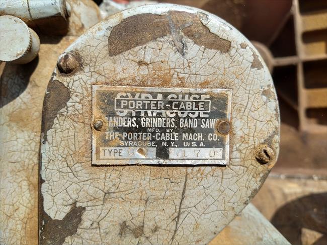

Tag with model and serial

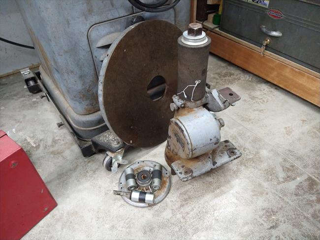

Down in the basement

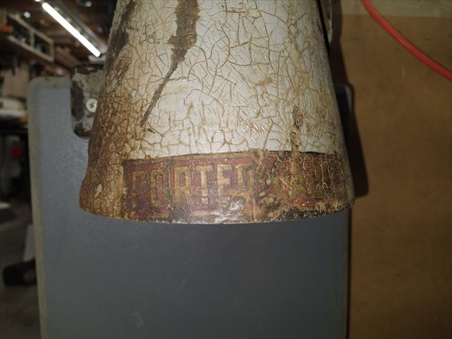

Appears to have been repainted, remains of decal

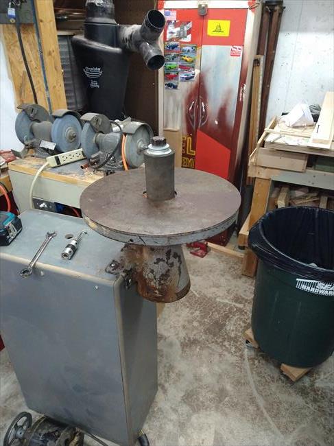

mounted on stand for temporary.

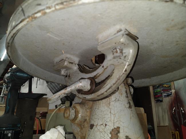

Tilt mechanism/Underside of table

1925 Ad
