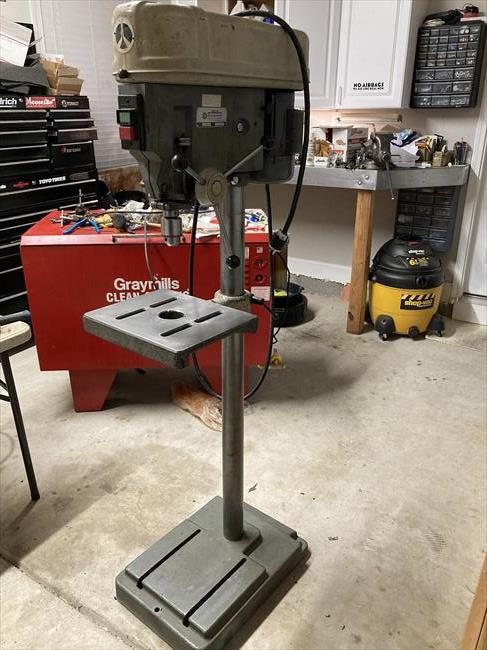

Purchased from an industrial location in Mooresville, NC that has changed their business over to a plastics industry.
Complete machine after working restoration. Spindle & Motor bearings: NTN 6203LB, Pulley-spindle bearings: 6205Z, V-belt: 3L440, spindle runout .002, modern jacobs chuck 34-33 runout .004, combined runout .006, missing Table Clamp Assy 402-04-027-5005, or
Alan K
Right side view, handles were 7/16-20 cold rolled, opted for screw on balls, table cleaned with naval jelly and scotchbrite
Alan K
Drill Press ID Badge, all hardware replaced with grade 5 (modern equivalent)
Alan K
Motor ID Badge, T5 and T8 are reversed (1,3,8,orange,,2,4,5,red)
Alan K
Jacobs 633C 33Taper Chuck, modern replacement 34-33C (c stands for collar)
Alan K
Original Switch Furnas Electric Company, switch disassembled and contacts cleaned/lubed
