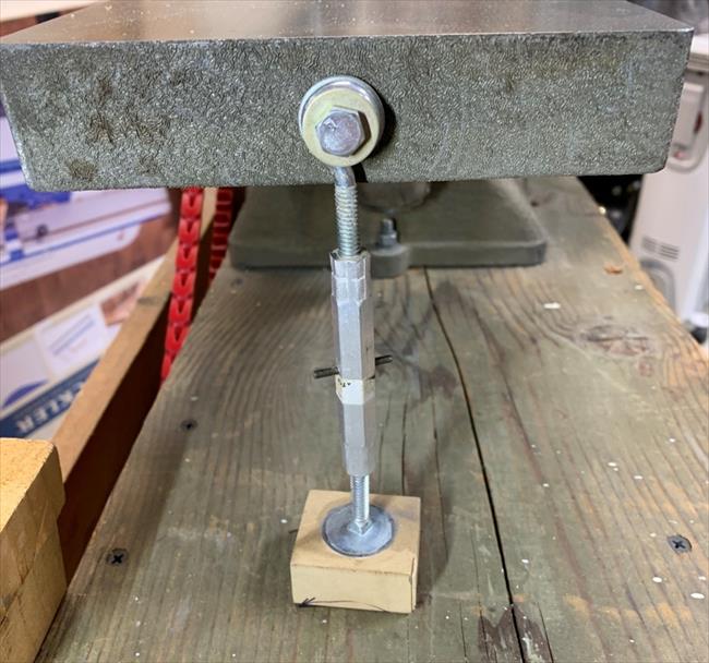

Note the small turnbuckle on the end of the outfeed table. I had noticed that when I used a long or heavy board my cuts would develop a cup along the length of the board. Found that the outfeed table would sag a few thousands on the last half of the cut. I snug the turnbuckle just enough to keep the table from sagging and it only needs adjusting if I adjust the height of the outfeed table.

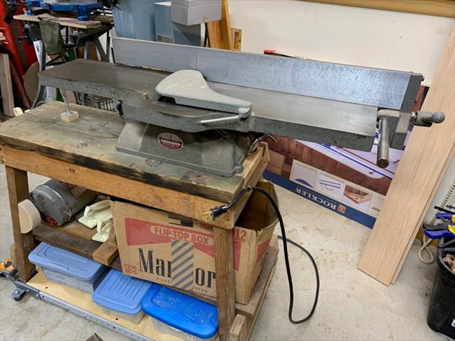

Comments: Upper side view

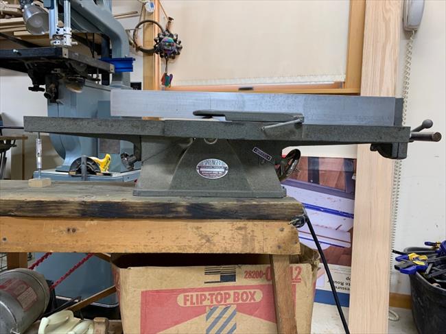

Comments: side view

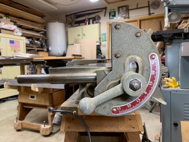

Comments: Fence adjustment

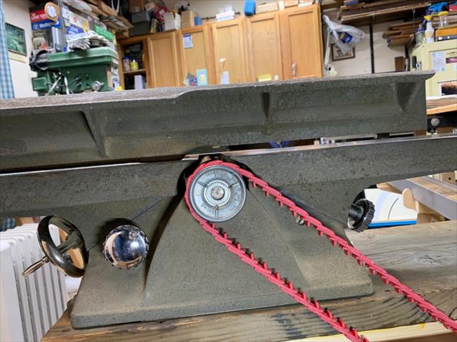

Comments: back side

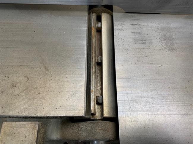

Comments: knife, installed

Comments: support turnbuckle
