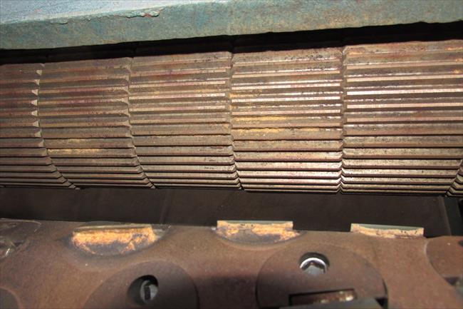

Another 299-D ITCH head Planer from a school auction
This one needed a complete rebuild. Note that the feed rollers that are not inline indicating broken springs and lack of prior service.
I can not find my post-rebuild photos of this one
Feed rollers Prior to rebuild
