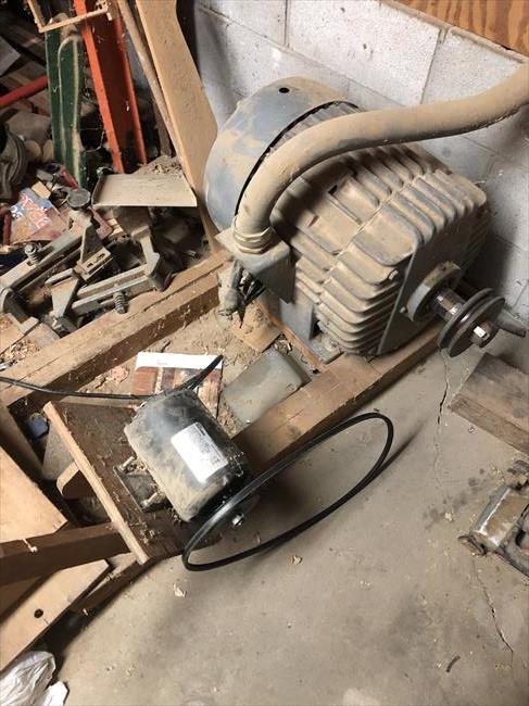

Have used this motor as a phase converter since 1985 can start up to a 25 hp motor the largest I have is 20 hp I use a 1 hp starting motor to get it up to speed then turn on the electric to it it is a three phase motor that once up to speed will run on 240 volts single phase and produce the third leg of the three phase off it’s winding
I run my hole shop off it it has never had a problem and has never caused any problem with any machine motor or switch
It does have a wild phase that must be kept off the starter magnet or it will chatter the contacts but move it off the magnet and that will fix it
50 hp
Showing the 1 hp starting motor on leaver
