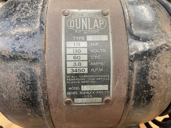

Sears Dunlap 6" ball bearing electric grinder.
Cast iron construction.
5/8" steel rotor shaft with 1/2"-24 threaded ends.
New Departure (USA) 8502 ball bearings.
Motor type SSO, 110VAC, 3.8A, 3450 rpm
Date code: F_4_1

Tag
iPhone 12 Pro camera-existing light
