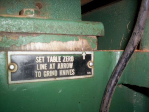

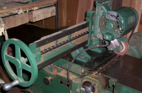

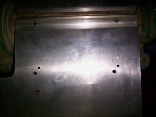

This is a rail and grinder setup for two of my machines. I removed the rabbeting ledge for clarity. In the first pic you can see the pin just above the brake that locates the knife at TDC. There is a pin in each of the legs that locates the rail on the outfeed table. There will be an additional pair of holes on the rail base for each machine the grinder is setup for. There is also a tag on the outfeed table to show you the grinding position. If you do not have the tag the setup was probably not done at the factory.
Comments: Grinder on 166-BD

Comments: Table with taper holes
Source: My Kodak
Comments: Grind position
Source: My Kodak
