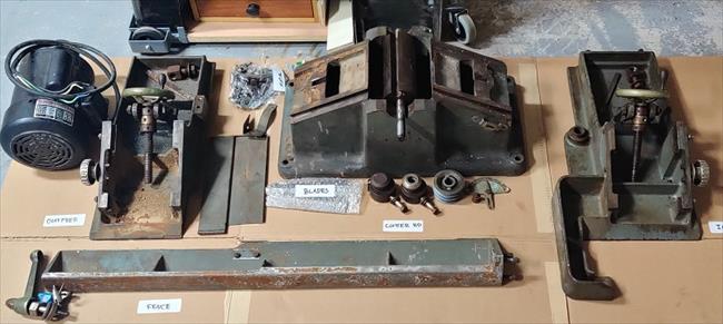

Purchased on FB Market for $300 in February of 2022. Had been in use in a cabinet shop until a few months before purchase. PO put a new Grizzly 1/2hp motor on it. Machine was in decent shape. Mostly complete. Only missing the guard. Don't have the original listing pictures. Only have the disassembled picture I took.
It had NO badges at all, so no serial for proper dating. The badges shown are magnets I printed up.
I believe it's a P912 because the parts list matches the machine exactly. Came with the "Texrope" triple pulleys, and the original 1/2hp Driver Line Motor (not pictured).
I think it's early 1950s due to K&T stamped on the fence, and the fence lacking a few small things the 6520 version has.
Bearings were in good shape so I just cleaned and re-greased.
Wasn't too concerned with matching the original paint color. I just did a nice blue color.
Put the Bora PM-1100 base on it. Great base if you swap out the cheap plastic swivel casters.
This has been fully restored and is running in my shop now.

Taken Apart Before Restoration.
My Shop.
