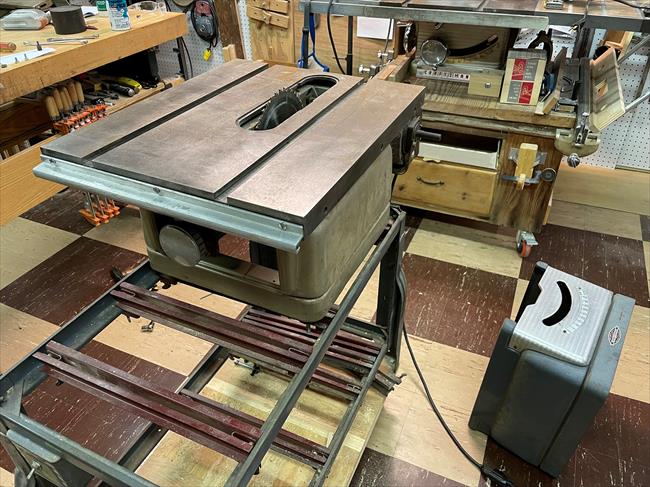

This post is a conversion experiment using an early 1950s 103.22160 saw and late 1950s 103.22171 cabinet+motor mount.
Both saws have basically the same stamped and fabricated steel base cabinet.

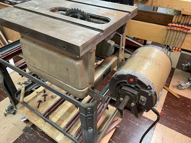

The 2216 saw has a separate sliding motor mount assembly.
The 2217 has a U-shaped stamped steel motor mount pivot bolted to the rear cabinet skirt, with a sliding motor mount on steel rod.
The 2216 saw was turned upside down and the tilt pointer, mono-control knob, and motor mount sliding actuator removed.
A 2217 cabinet was bolted to the table bottom (the 2216 front panel fits the 2217 cabinet but was left off for convenience).

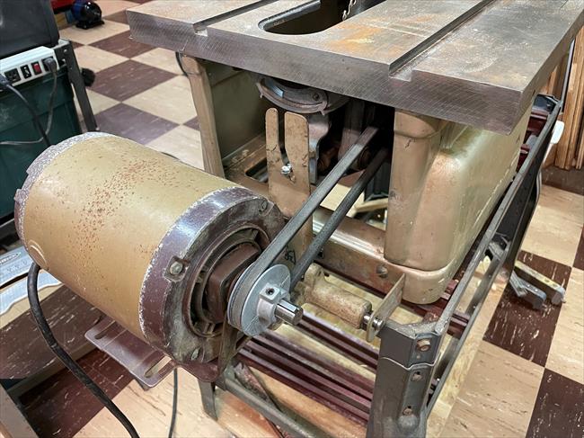

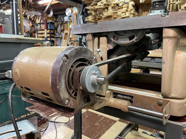

The saw rig was attached to a 16x30 Universal stand with a Craftsman/Packard 115.19920 3/4 hp 3450 rpm motor, 2.5" pulley, and 34" V-belt.

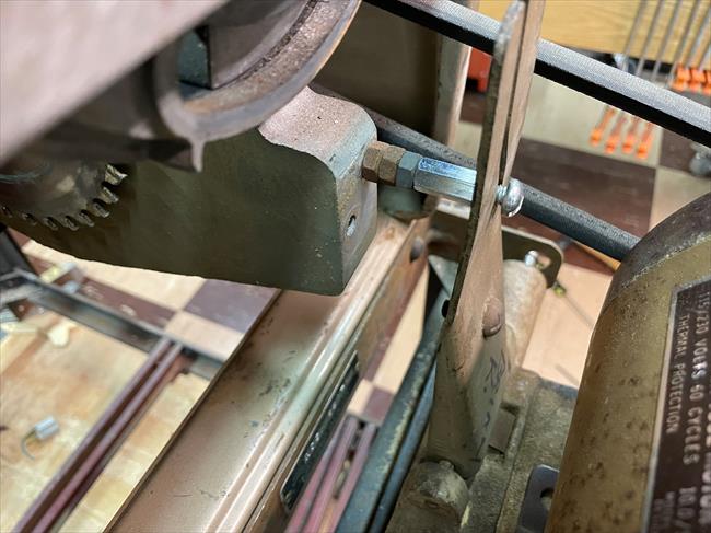

A motor mount actuator, attached to the carriage, was fabricated from a 1/4-20 round head bolt, coupler, and three nuts.
Trial runs and test cuts were made successfully.
Conversion to 2217 cabinet complete, front face panel does fit but transfer wasn't necessary.

2217 motor mount.

Fabricated mount sliding actuator.

Motor a 90° blade position.

Motor at 45° blade position.
