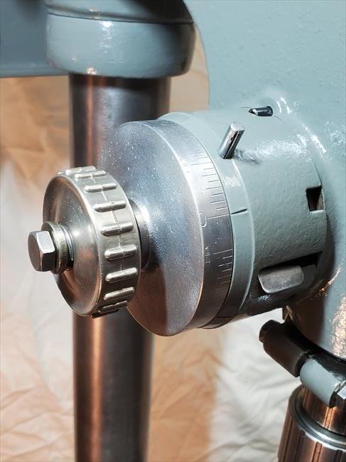

Aquired during 2021. I am currently baffled where I bought the majority of this press. One possibility is that it came out of the school system in Fulton, NY. Some parts were supplied from a donor press bought in Fall River, MA. That press was used in a local textile mill. The micro adjustable depth stop has a definite cool factor to me. The assembly on the dirty paper shows the 2 lock nuts under the under the adjuster. I will probably move them to above, I think I'd rather make adjustments towards longer quill travel. installed new spindle and motor bearings (The Driver) cleaned/re-greased the spindle pulley bearings. The run-out on the spindle taper is .001.

close up of ci. depth stop
