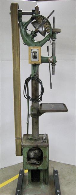

Machine Type: Drill Press
Machine Size: 12"
Submitted By: Mel Miller
Description/Model: Variable speed drill press.
Date of Manufacturer: ~1910
Serial Number: 1481
Last Updated 2/23/2022 1:08:41 AM

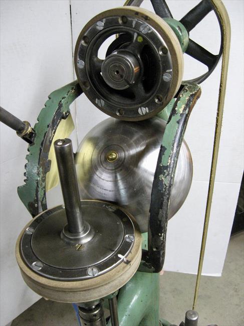

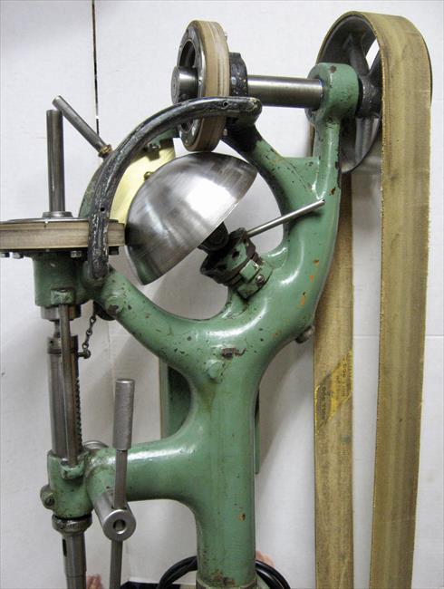

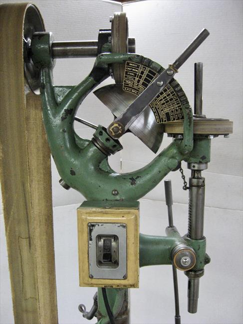

Unusual friction drive drill press. The hemisphere in the middle is pivoted forward/back to change the speed.
Patented by Saxon J. Morgan in 1908. Mfg. by Albany Hardware Specialty Mfg. Co., Albany, WI Some models were lineshaft belt driven.

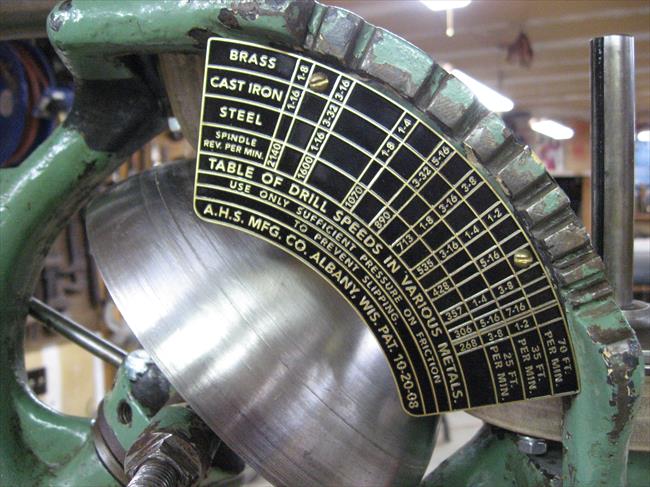

This was found with no data plate and it took some time to find the information needed to have a new proper plate made.

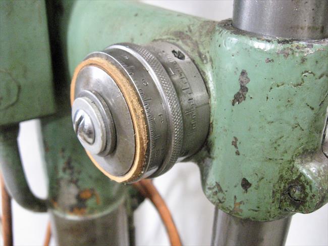

Note that the depth scale ring can be reversed for inch or metric use.

Comments: AHS drill press
Source: Mel Miller
Comments: AHS drill press drive
Source: Mel Miller
Comments: AHS drill press speed changer
Source: Mel Miller
Source: Mel Miller
Comments: AHS drill press speed /nameplate.
Source: Mel Miller
Comments: AHS drill press depth scale.
Source: Mel Miller
