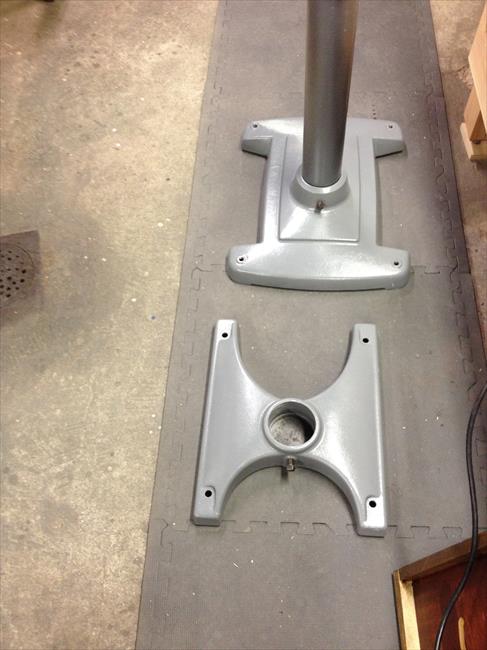

Base, column, top.
My iPhone

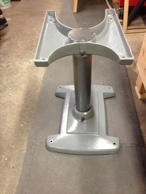

Assembled stand.
My iPhone

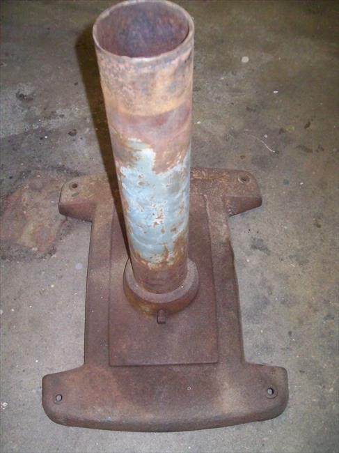

Base and column as found.
My iPhone

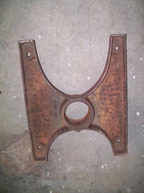

Top as found.
My iPhone

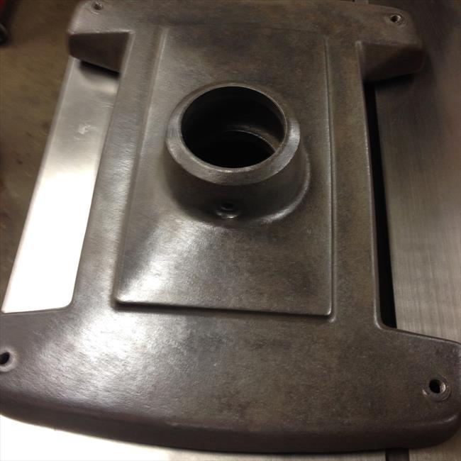

Base ready for paint after electrolysis..
My iPhone

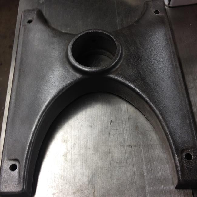

Top ready for paint after electrolysis..
My iPhone
