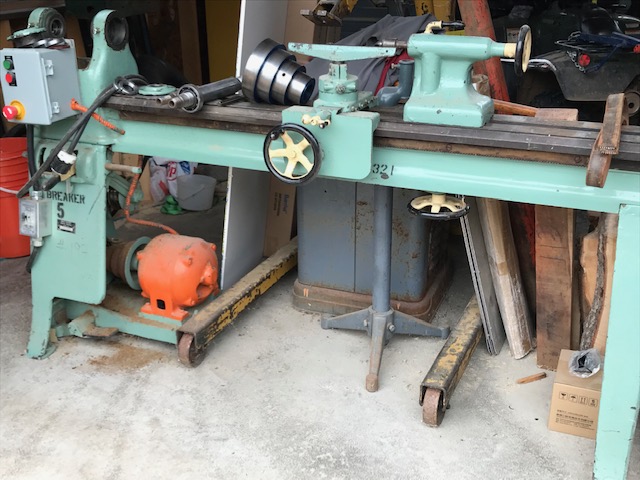

I bought this from a government auction several years ago, and am just getting around to putting it in service. I plan to:
Turn down the spindle from Whitworth to 1"-8tpi
Drill a through hole from outboard to inboard of the spindle
Change motor to 1.5hp single phase
Replace the old leather flatbelt
Spindle removed

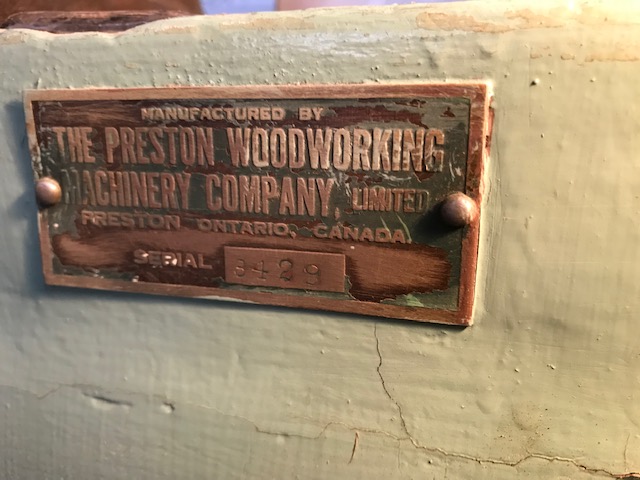

Machine tag

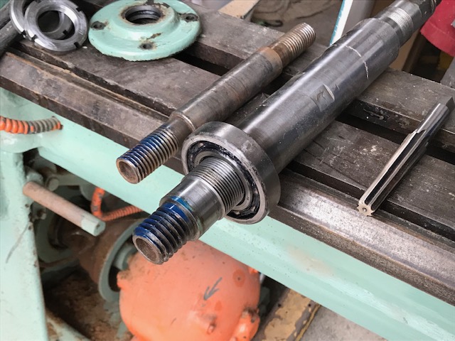

Spindle and Delta spindle for comparison
