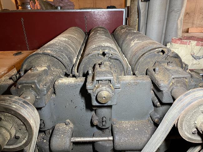

It is clearly an old flat belt machine, and although the wide sheaves are gone, the shafting remains. The shaft ends have been converted to V belt sheaves, and there were 4 single phase motors powering it. A 5 hp motor runs each sanding drum, and a 3hp motor runs the conveyor. The drums are 8” in diameter and have an internal spring mechanism that looks like it allows the paper that is wound around the drum, to be tensioned. There is also a thin strap at each end of the drums to lock the paper in place. Conceivably, with a motor for each drum, each drum can be operated independently of the others.

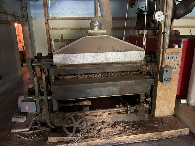

The machine is in remarkable shape, and had been running not so long before I saw it, and was still hooked up to a working dust collection system. There is one small repair where a corner of the outfeed table was bashed, but it was nicely done.

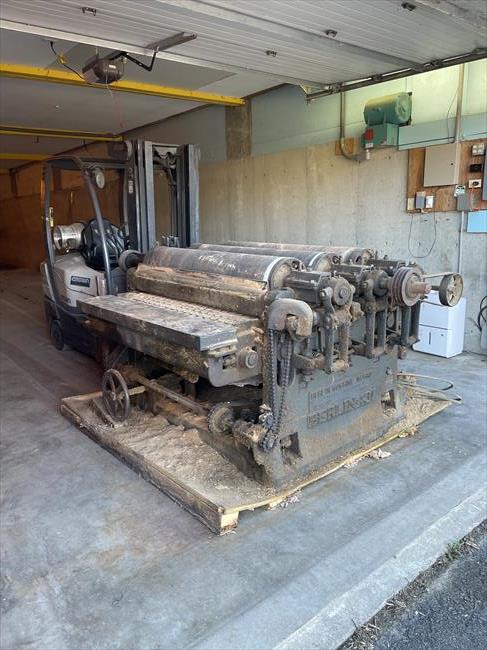

Comments: Outfeed to the right

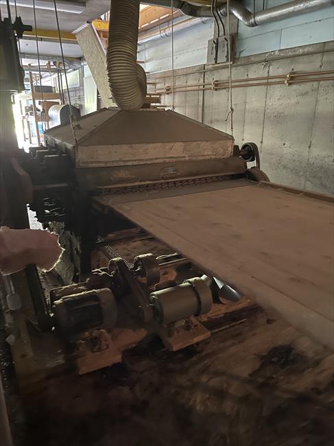

Comments: Infeed side to the left

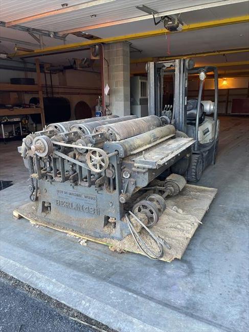

Comments: Machine as found facing the outfeed table

Comments: Machine as found, facing the infeed end

Comments: Dust hood removed, showing sanding drums
