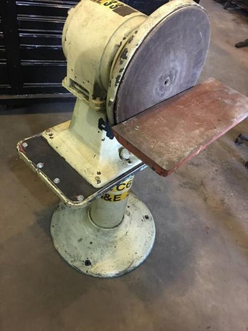

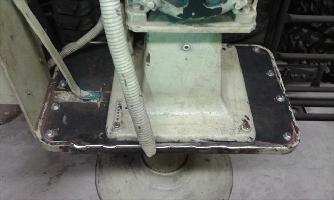

Fortunately, I ran across this sander posted on the web back in July of 2017 while it was still available and was able to obtain it. As my main interest lies in early (pre-1945ish) tools made by Delta, I found it ironic that I bought it from an automotive restoration shop located in Delta, PA. The owner had purchased the sander from a government auction 6 years prior. Unfortunately, one of his workers had knocked it over into forklift (it did not fall completely over) which damaged the base which he “repaired” by fabricating a large steel plate which he through bolting to the table. The original GE motor had failed at some point during its life and modifications were made to the sander to adapt a replacement motor:

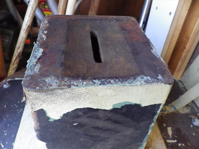

1. The top of the cast iron riser column which had been curved to directly accept the body of a GE motor was machined down flat

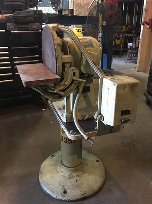

3. A huge Allis-Chalmers 1 HP 3 phase motor was mounted to the steel plate

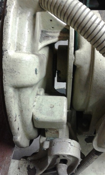

4. A steel ring was fabricated and bolted the front of the motor end bell to adapt the dust shroud to the motor

Front view

Side View

Custom steel ring to adapt replacement motor to dust shroud casting

The "repaired" table by through bolting steel plate.

Top of Riser Column was machined flat to accept replacement motor. (Note: motor and steel adapter plate are shown reemoved here)

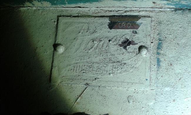

Serial Number 30
