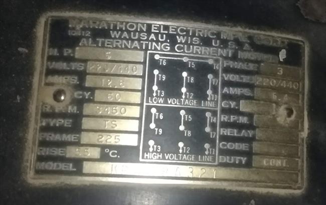

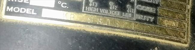

AC Motor 5 HP 3Ø KR98A321
10/21/2021 9:25:15 PM

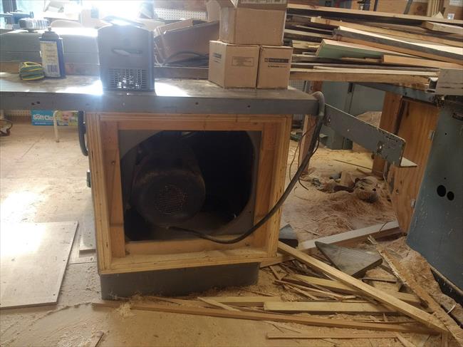

This is the motor from http://vintagemachinery.org/photoindex/detail.aspx?id=41117
Its a 5 HP 3-phase motor. I need to take it out of the saw, clean, check/replace bearings, and re-wire to power source. I should try to weigh it when I'm doing that, it seems to be rather huge for its power. Totally dwarfs other 5HP motors I have which are more modern. If its original to the saw it would date probably from the late 1940s.
