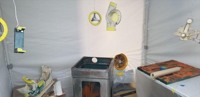

Makeshift paint booth (not such a great idea)
self
