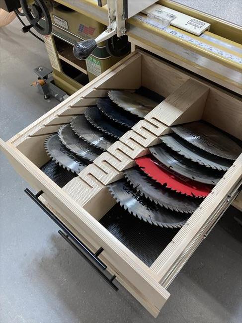

Comments: Bonus pic showing drawer for blades
Source: Owner
