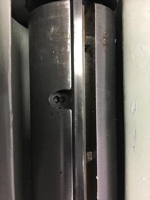

I purchased this from a young woodworker that was buying all new equipment for his shop. It was in running order, but I knew I could make it at least better looking. I stripped the machine completely. Sandblasted all the painted components, primed and repainted. I gave the base to a friend that already had 1000 with no base and I was going to make this one mobile enough to go up and down an 11 degree ramp at my shop in Maine. I work outdoors there. I made the new base out of baltic birch plywood. It encloses a 3 HP 1 PH motor. There is an open slot at one end of the base to blow out dust and stray chips that find their way in. The cutter head was re-machined putting fine thread jacking screws under the cutter knives to make for very quick alignment and blade setup. I have a special jig I made with dial indicator built in to it to set the knives to the correct height in just seconds. I have CAD drawings for those interested in that head modification. I can also send a picture of the knife jig. I created a dead simple fix for the common teething problem with the 1000. When the drive mechanism is disengaged the belts "fall" under their own weight onto the pulley and therefore never really fully disengages. A strong neodymium magnet with an aluminum post tucked up under the belt keeps it from staying engaged on the pulley. I also found the side gear cover did not align quite right. Some turned stainless necked washers used under the stainless mounting bolts keeps everything perfectly aligned.

Comments: Showing jacking screws mod to cutter head.
