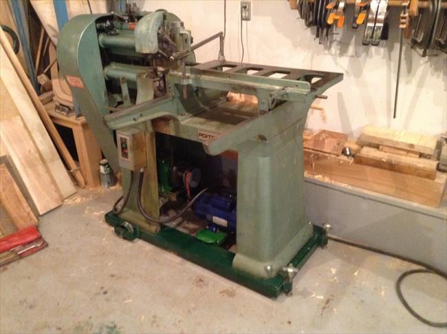

Comments: I made the mobile base with 2x2 iron angle and13/4x5 maple spacer
Comments: sold by Continental machineries Montréal Québec
Comments: missing the saw blade and bushing vertcal shaft assemlby from botton
Comments: I made the counter shaft to replace the550 volts motor double shaft and run on 220 votls 1 ph
