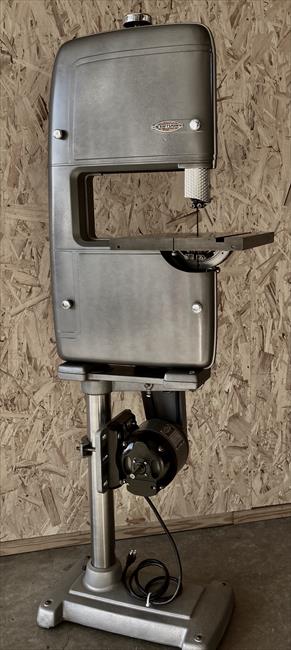

Acquired for $50 from a retiring general contractor. The machine belonged to his father and had not been used for the last 45 years but was stored indoors. All parts were original including the stand and 1/3hp Dunlap split phase motor. The saw was completely disassembled and all rusty parts were cleaned up in a molasses bath. The inside is painted with Rustoleum gray and the outside is Rustoleum metallic. New tires and 1/2" 3tpi blade were installed. The motor and top wheel have new bearings.
Comments: Final assembly
