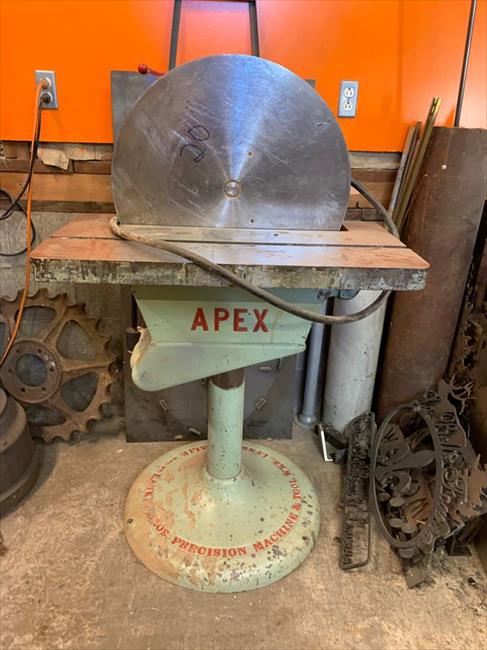

I have long wished for a larger disc sander, and to have found not only a West Coast one, but a hitherto unknown (presumably earlier) iteration of the Rankin Brothers’ business was irresistible. The name cast around the round base on this sander is *Rankin Bros. Precision Machine & Tool Wks., Lynwood, Calif.* Which is similar but different from the *Rankin Bros. Manufacturing Inc.* listed here. The sander comes to me lacking the brackets for attaching the “wrap-over guard” to the motor as a previous owner replaced that motor and seems to have thrown away or lost the brackets in the process, but sporting a rather impressive 3hp Baldor motor, rather more hp than would have been originally spec’d on these: 1-1/2 or 2hp for the 20” model and 3/4, 1, 1-1/2 or 2hp for the 16” model. It appears rather complete and not mistreated.
full view of machine, note the round base
seller’s photo for now

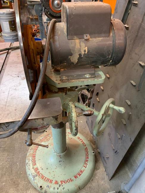

table elevation and tilt, base, new motor
seller’s photo

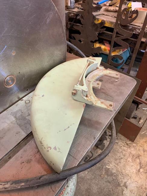

wrap-over guard, minus brackets
seller’s photo

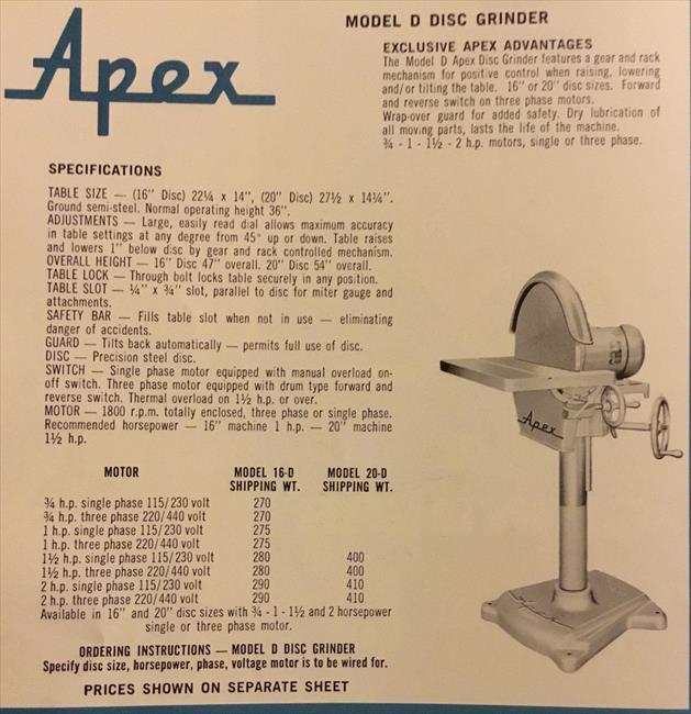

brochure page showing the successor model to mine
Courtesy of Barbo Machinery in Portland, Oregon

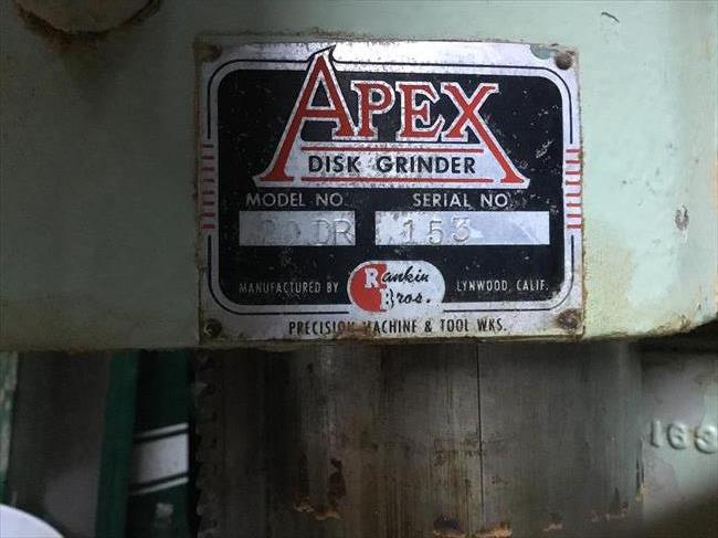

Badge
own photo
