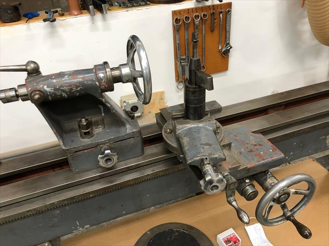

Tailstock with revolving center and Traveling Slide Tool Carriage

Traveling slide tool carriage
