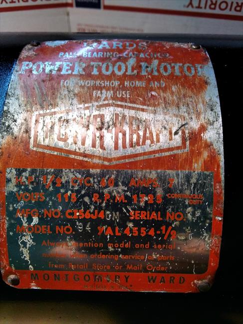

1/2 H.P. 7amps, 1725rpm
Aaron Ginsberg
YAL4554-1/2 A
MFG no CI56J4CN
CF
8/4/2020 7:52:30 PM

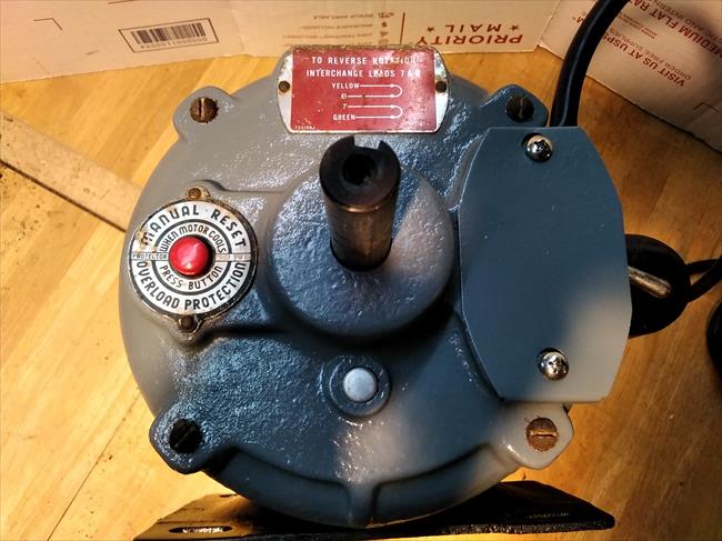

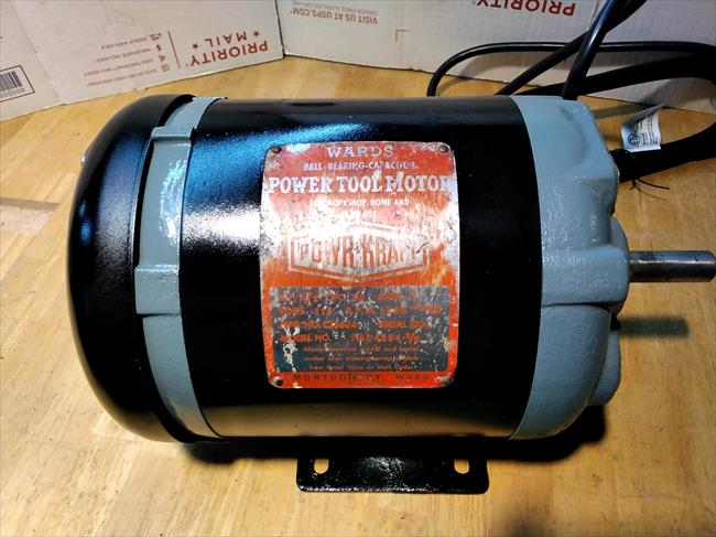

Purchased off Craigslist in the Boston area along with a much older grinder. Was pretty rusty and needed a new cord and reset switch. Got a good cleaning inside and out and a new coat. Motor runs very well. Glad it didn't need new bearings as the fan is thin metal and held on the the shaft with a compression fit. Would have damaged it if I tried to remove and reinstall. Could not figure out who made the motor, but would like to know.
Finished up, front view
