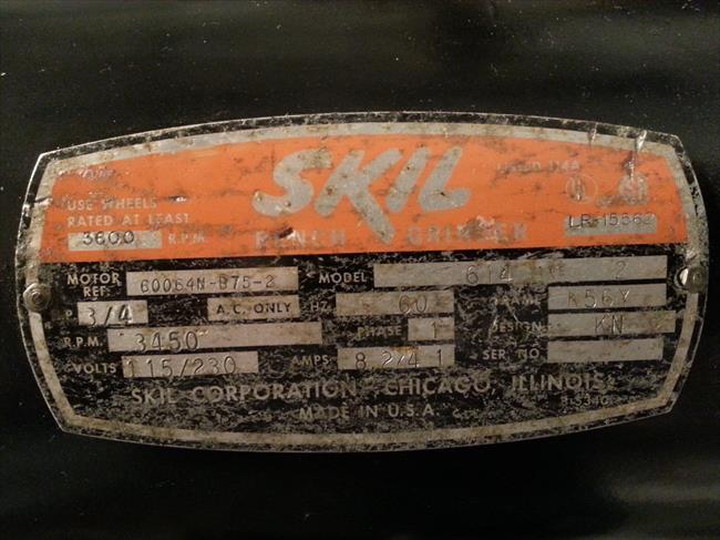

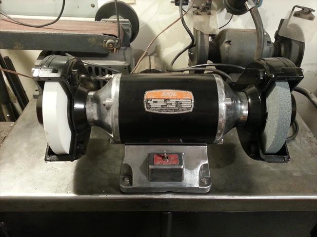

Needed new bearings and missing some parts. still fab'ing up one tool rest and cleaning up the shields. It also needed bearings. I pulled what was in there and found I had a pair that fit - 6204-2NSE9NR Nachi Quest and removed the retainer clips not needed. I polished out and cleared the endbells and painted the body. Cleared the motor and switch tags after a light clean.
after

motor tag
