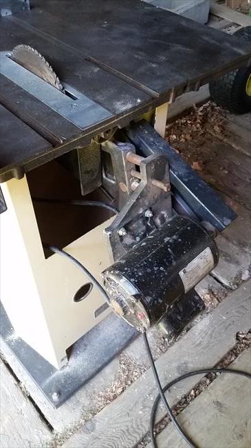

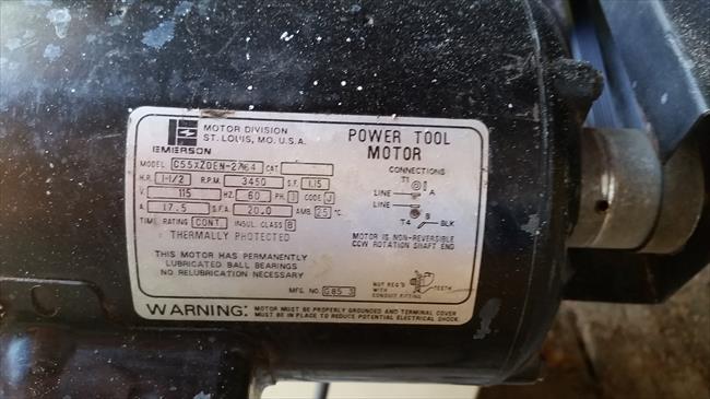

The motor is an Emerson Motor Division Model C55XZDEN-2764, 1-1/2 HP 115V 17.5A with thermal protection. It uses a V-belt with multiple tracks to prevent slipping (visible in the photos).

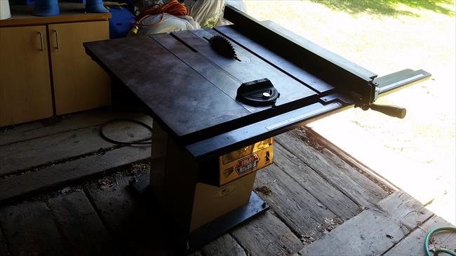

The table top is cast iron. There is the center section and two wings, one on each side. Assembled the tabletop measures 28" x 40". The "stand" is hexagonal and the square base measures approximately 22.5" x 22.5". It has four adjustable feet at the corners of the base.
The fence and miter gauge appear to be original. The handle on the fence used to clamp it in place is not original, I added that myself. When I purchased the saw there wasn't a handle, so I cut off a piece from an old chair leg to use instead.

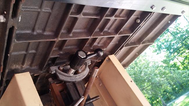

The bevel adjustment rod was unscrewed quite a ways by the previous owner which is why the bearing is about 3 inches out from where it belongs. There was also a cover over the bearing that I removed myself so I could remove the handle and flip the tabletop around.

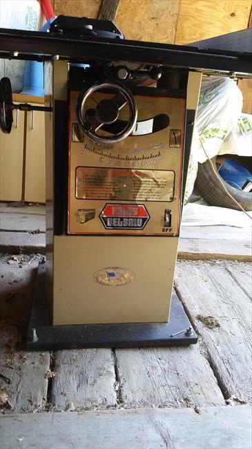

The main power switch was replaced with a light switch by a previous owner.

Overall photo of the saw

Front label of the saw.

Underside of the tabletop

View of the rear of the saw showing the motor and some of the mechanics

Motor label
