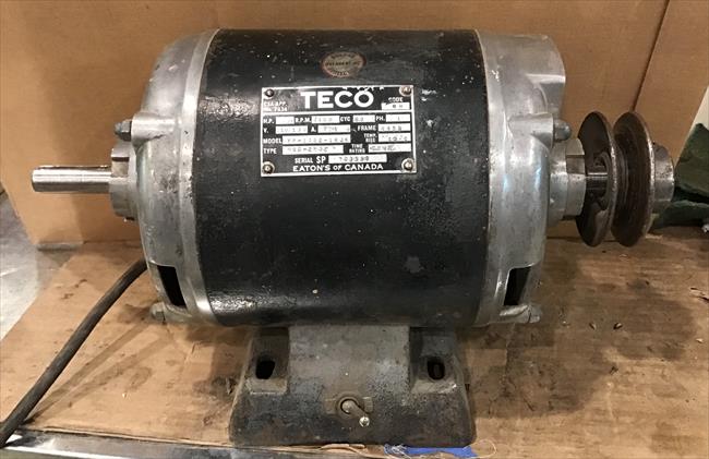

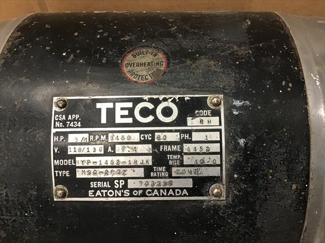

Motor
3/4 hp
M P
MYP-1452-1RJK
SP703538
6/10/2020 6:56:01 PM
Purchased this motor yesterday.

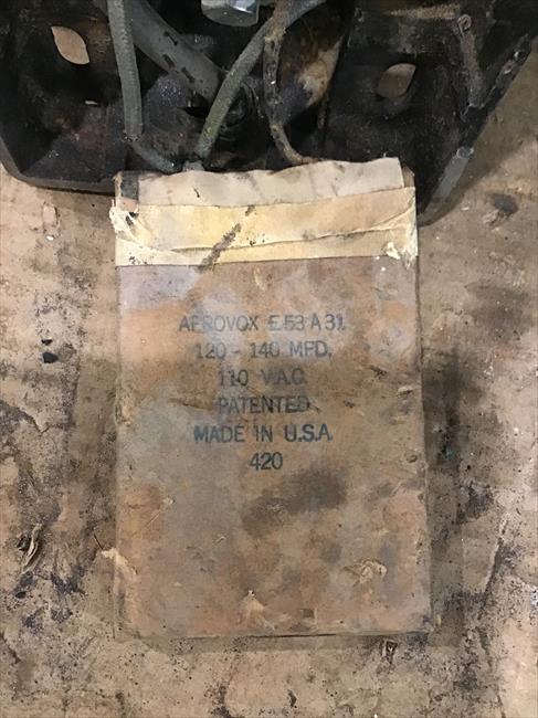

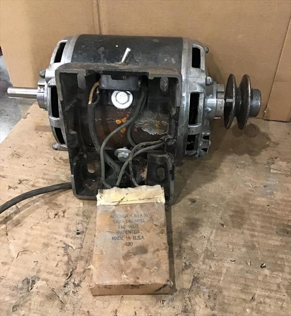

There is a square capacitor in the base.
Space is pretty thight. And there is nothing to hold the capacitor in place. Weird. I don’t quite know how to go about that.
If somebody else has the same motor, I would surely appreciate some info/pictures.
(A new cylindrical capacitor would measure 1 7/16" and would not fit. I checked)

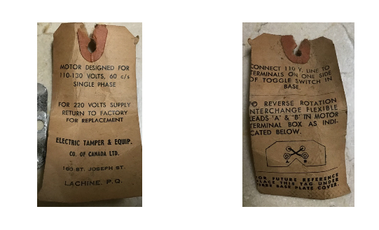

The next day, I made a bracket for the capacitor and cleaned it up. I found interesting information in the electrical box. The motor seems to be made by Tamper. The info is on picture no6.
