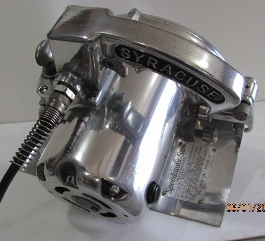

Found this in a pawn shop maybe 20 yrs. ago. Took it all apart and cleaned it thoroughly, used Mother's polish on the polished surfaces and just toothpaste on the badges. New Porter Cable gear grease and power cord. Saw has a 1/2" arbor (not the usual 5/8"), but there is a P.C. 1936 Price List on this website that says all blades listed had a 1/2" hole. Just an old way of doing it. This is why I list it as made in 1936. It cost $115 then, that's $2000 today! But it was productive and super robust.
Polished cast aluminum housing.

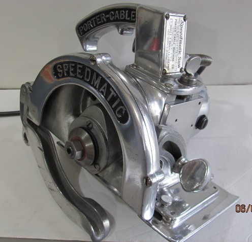

Old style blade guard hinges at the back.

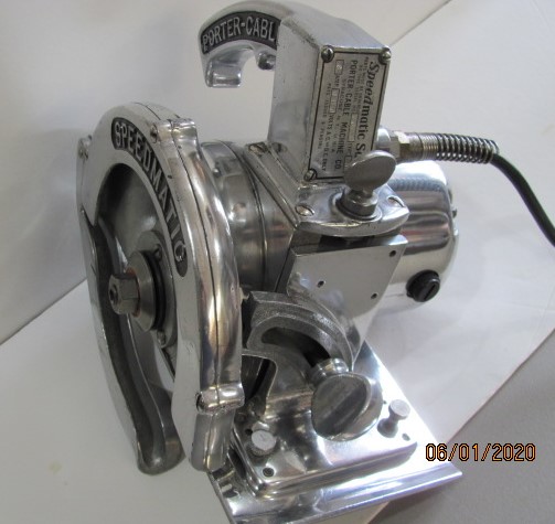

It's like a table saw motor with a handle.

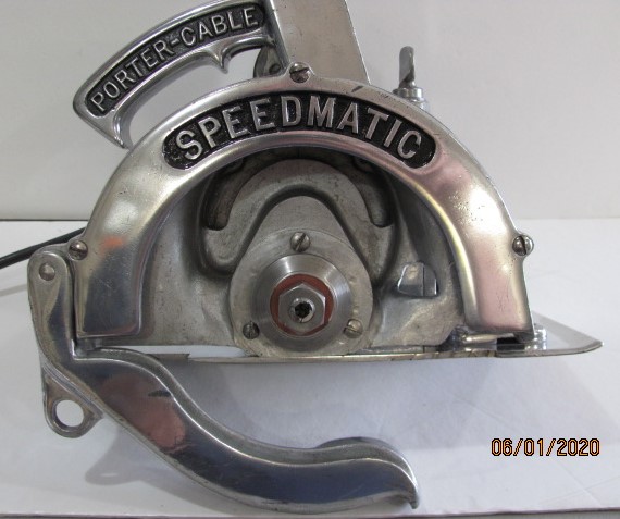

Pretty good for an 84 yr. old.

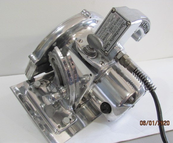

Still runs strong and smooth.

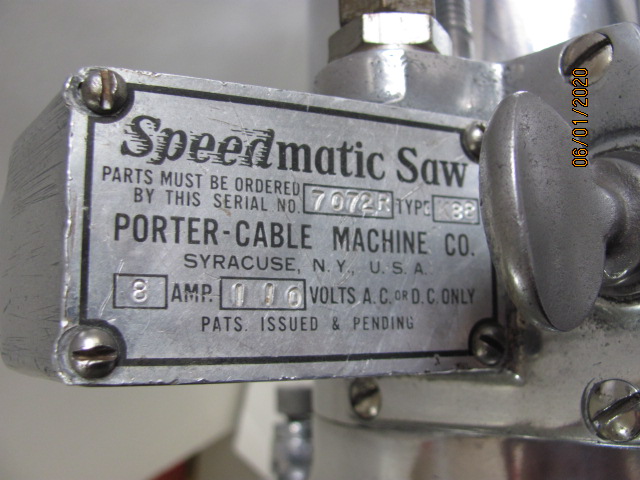

110 Volts A.C or D.C. only.
