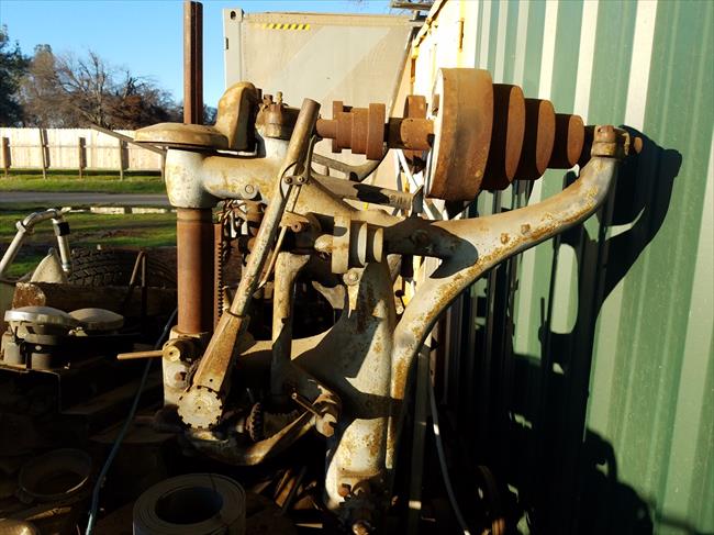

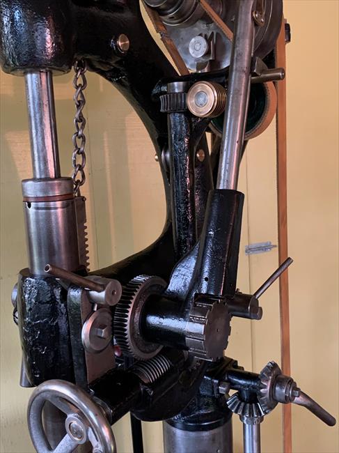

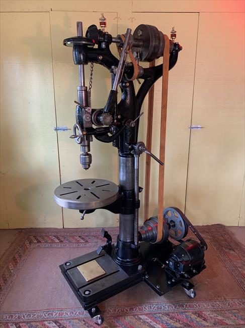

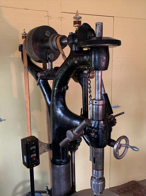

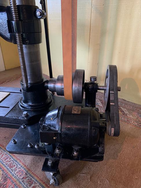

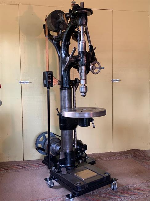

found this in a row of upright drills. i selected it for the planetary gears and power feed. I made a new table surface, milled a new worm gear for the powerfeed, and basically gave it the standard cleaning and painting. A new stand on wheels helped the situation. Also, it was line shaft when I got it so I converted it to electric using an early Holtzer Cabot motor and Westinghouse switch. Now I am drilling holes like it's 1900 again!!
1920s westinghouse switch
