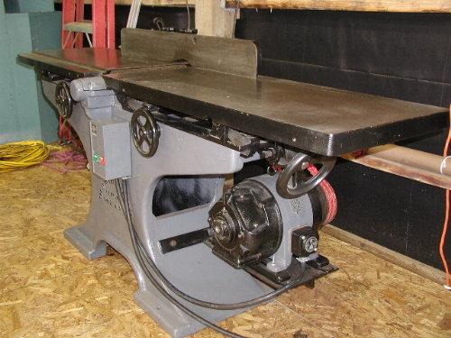

This machine was purchased from a storage/shop rental owner. The previous owner of the jointer left in a hurry without paying his rent. I purchased the jointer at true bottom feeder prices. The cutterhead is an aftermarket 2 knife round head manufactured by the Henry Disston and Sons co. It is probably a replacement of an old square head. The motor is a 2 hp Fairbanks Morse Repulsion induction 230v single phase workhorse.
Comments: 12" Crescent side
