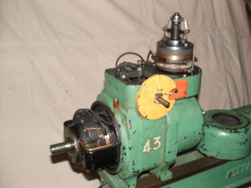

The motor is quite unique. It is a dual voltage, single phase Repulsion motor (not RI). It is variable speed, 600-3600RPM, controlled by a fly-ball governor. The governor is driven by a jackshaft that is perpindicular to the armature/spindle shaft. The jackshaft is driven by a spring loaded leather cone clutch directly from the armature shaft. The governor assembly is shown in the second picture. The governor operation is simple. It regulates the flow of current in the armature, opening the connections to the brushes when it is at speed. The governor is adjustable. I tweaked the setting to get the dial speed to correspond to the spindle speed, checked with a hand held dial tachometer. Once set, it seems to hit the selected speed quite well. The literature indicates that they do a good job of maintaining the selected speed under load. We shall see if that hold true.
The motor is rated at 1/2 HP and 5A/220V. The motor must weigh close to 200 pounds and has very large bearings. I think 1/2HP is an awful conservative rating.

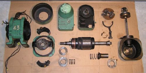

The third photo shows the motor in an exploded view. Parts are, left to right, top to bottom:
Field coil assembly
Outboard end bell
Governor housing cover
Governor housing
Governor contact assembly
Governor
Upper brush holder
Governor speed adjusting fork
Outboard bearing frame
Armature (with threaded bearing retainer for inner race)
Inboard end bell with governor jackshaft and driven cone
Lower brush holder
Outboard bearing retainers, outer race
Governor drive cone with spring and locking collar
Inboard bearing retainer, outer race
The main bearings are 1207 double row, self aligning ball bearings. The jackshaft bearings are 1204's.

Motor/Headstock showing fly-ball governor

Exploded view
