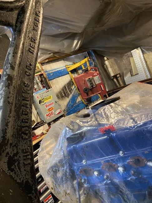

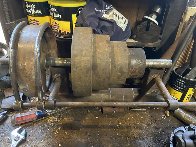

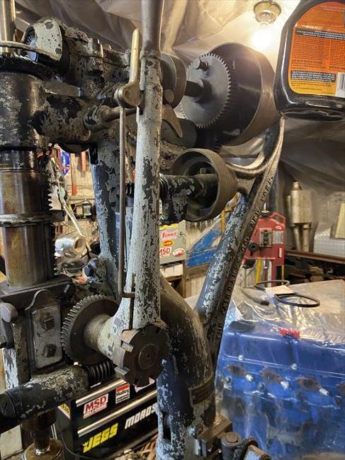

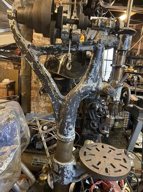

This is my Fairbanks co camelback drill press with power feed. My friend purchased it in New Hampshire for me for $200 and brought it to my shop in Ct, it’s was missing the lower cone pulley bracket and slip lock pulleys. I have acquired a 4 step cone pulley that is the right belt width and diameters for each step. And I have been fabricating a bracket just need to make sleeve bearings and add another 2 inch wide pulley to run loose. The side handle was busted only had one of the parts so I welded the one part I had back on it.
Comments: Fairbanks co drill press
Source: Myself
Comments: Fairbanks co raised cast letters
Source: Myself

Comments: Lower cone pulley with bracket I’ve been fabricating
