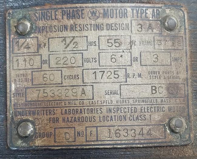

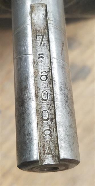

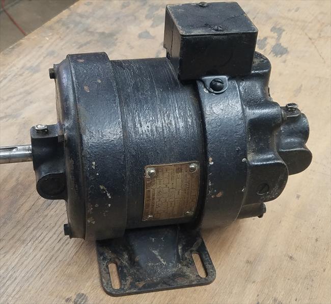

Picked up in a group buy of some equipment in Poughkeepsie, NY. Seller had no prior information. Three things to note, the hazardous location rating, number stamped in key way and the company address on badge is East Springfield, Mass. It runs quiet with a bit of end play.
Edit 3/14/2022 It has been suggested the 1/2 hr duty rating and construction lends the motor to possibly have been used in a early gas pump. IDK
Edit 2/22/2022
Added manufactured dates
Added information sent to me by P. Baisley

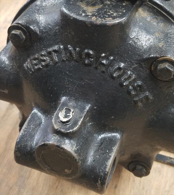

The tell about this motor is where it was made. Springfield, and East Springfield (Chicopee) MA. In 1918 or so, Westinghouse formed a subsidiary, Eastern Westinghouse, and bought two factories in MA, one was an arms producer, another a car maker. They tried, and failed at guns, and sold that factory, and converted the car factory into consumer goods, like motors. And the first commercial radio station. The subsidiary went under in 1926.
Edit 2/26 From another member "I would like to suggest that your motor was made in 1931. The "BC" serial is a date code, and the "C" (I believe) corresponds to 1931 or 1957. Also, the ID plate on the left side has a 1931 date. (This is a date for the design/format of the ID plate, not for the motor, but it sets the earliest possible date for the motor)."
badge
side view
me
nice cast
me
shaft
me
