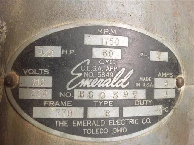

Emerald Electric Co.
Adrian, MI; Toledo, OH
Motor
1/2 HP
Bill Widmer
Single Phase Repulsion/Induction Motor
B60397
1/7/2020 7:39:23 PM

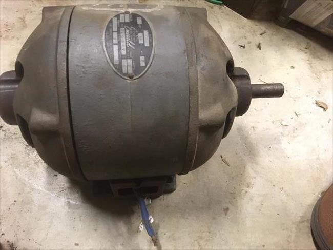

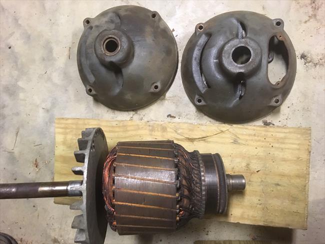

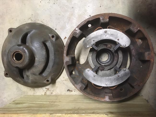

Rescued from being scrapped. This was off an old 60 gallon liquid mixing tank that I believe once belonged to NASA. It drove the mixing impeller. Labeled as being from Emerald Electric, Toledo, Ohio. R/I design that runs fine but the cloth covered wires were frayed, definitely a shock hazard, and now have been covered with heat shrink. Filthy inside and am in the process of cleaning and replacing the bearings.
The Motor Tag

Motor complete

Windings
my camera
End Bells

Armature & End Bells
