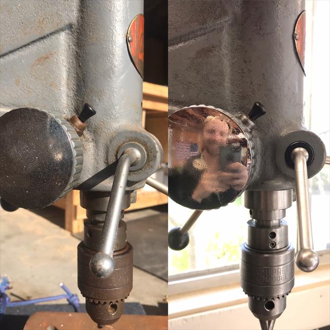

The conservation of the drill was straight forward as I prefer to retain original paint if enough of it remains. The quill was fully disassembled for inspection and had the oil inside replaced. The bearings are in good condition, so I did not remove or replace them. Select parts were blued for corrosion resistance. The machine was cleaned of soiling and corrosion before application of Renaissance Wax which will preserve and protect the surface. The motor that it came with was shot, so it was replaced with modern 1/2 hp Dayton split phase, it works great. I tried to balance the chuck it came with as it had a wobble, ultimately it too had to be replaced with a new one from McMaster-Carr. It now runs super smooth, quiet and has almost 0 runout.

Before and after.
Erik S.
