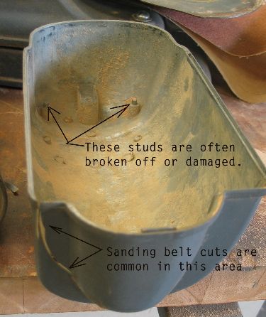

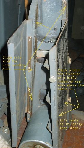

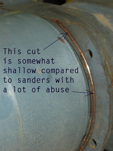

These details show various problems one can encounter when buying a used sander.
Table and inside grooves
my camera
sander top cover

Lower body sanding cut
