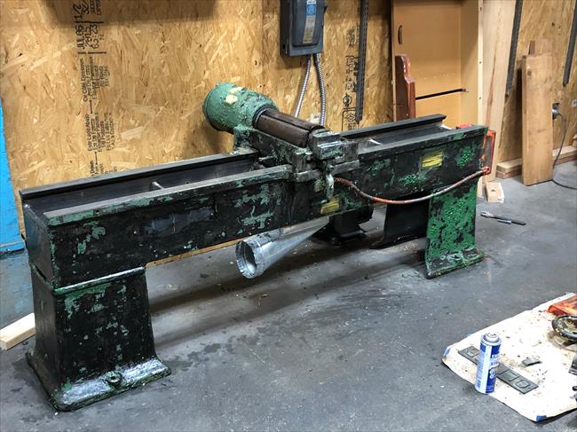

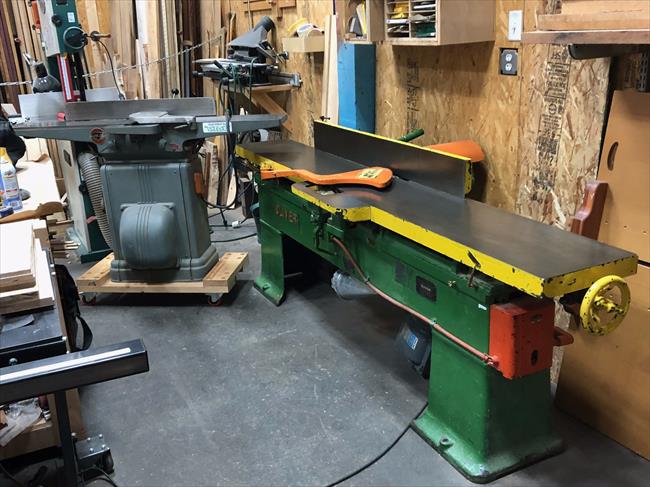

Machine was purchased from an online auction to replace a Delta 8” with the Art Deco base. According to Eagle tools, I acquired it from the same Chicago school district that bought it new in 1948. The jointer is original except for the round handles that a great friend turned. It was purchased with a horrible John Deere paint job and years of dust and grime but taking inspiration from Mike Korsak, I mimicked his black and red paint. Tearing the machine down to the last nut is a lot of work but provides a great lesson in how your machine works. My shop does not have 3ph so I chose to run a 7.5 hp Rotary phase converter. Hope to add a few more solid old tools to the shop once my loving Wife recovers from this one.

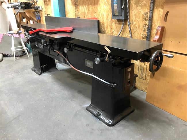

Almost finished! Just need to restore the badges and replace the old conduit.
My phone
Out with the old and in with the new old!
My phone

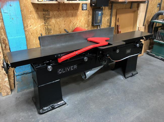

Wasn’t easy but worth the effort
My phone
Thanks again to Chuck Beck for turning the missing handles
My phone
