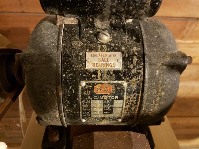

I purchased this off of Craig's List in Utica, NY for $200. It has a KC 1/2 HP AC Motor that runs a bit over 1700 RPM.

KC 1/2 HP AC Motor
Brian Foster
