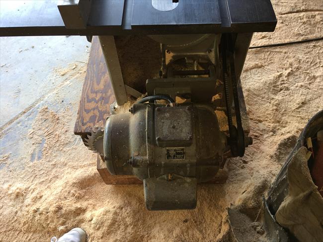

One of the company's employees started Westbuilt Metal Products Company, which made Timberline table saws. He built at least one prototype of his table saw in the Parker Mfg. Co. shop, and gave it to my father out of gratitude for letting him use the shop to build his prototype. This was probably in the late 1940s. I now have this table saw (which is pictured here).
I suppose the table-saw manufacturers of the time were backlogged also. Perhaps that is what prompted the entrepreneurial Parker Mfg. Co. employee to create this product. It was evidently built as a bench-top model to be attached to a support provided by the user.
