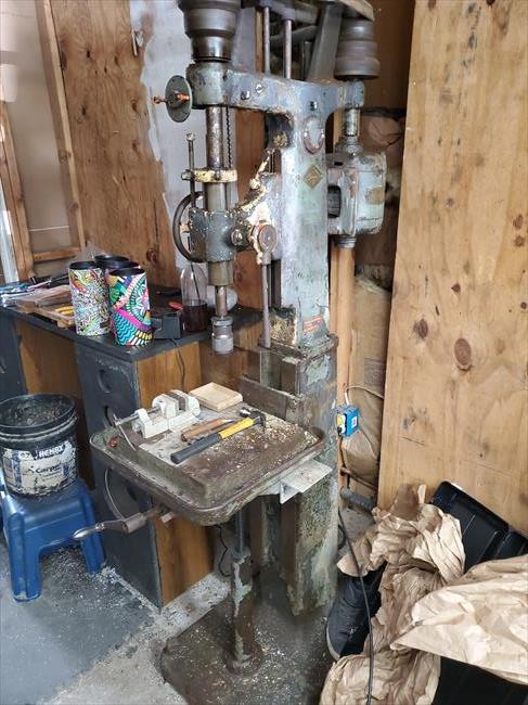

Purchased in 2018 on Long Island from a widow of a hobby machinist. Other machines at the location had auction tags so no history prior to that.
Transported in 3 major assemblies: top, table and base. Approximate weight is 800lb. Upon assembly plugged in and turned right on.
MT1 ROHR chuck was stuck very tight. The belt tensioner is not functioning fully so belt slippage happens at higher torque cuts. Belt condition is fine but will be replaced. Motor is loud due to bearings not being in best shape. Will be replaced with a DC motor and speed controller.
Comments: Overview

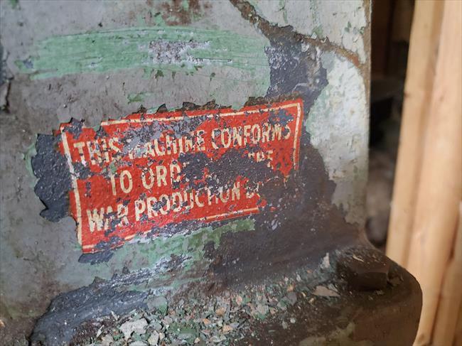

Comments: War production tag, screen printed
