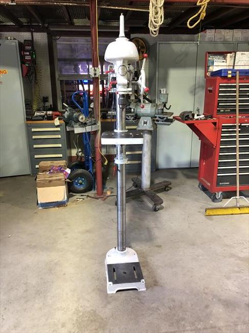

This DP was spotted in a MarketPlace forsale post for $100. It had sit outside for 4 years and was in bad shape, but it was all original. I took it completely apart, cleaned, oiled and repainted it. I replaced the wore out belts, the quill cover which had been cut off and on reassembly, I dropped the table down the post and broke the tilt table clamp. I purchase a used clamp off eBay for and when it arrived, it was broken also, so I am still looking for a clamp. If anyone has a spare, please let me know.
I didn't follow the original paint scheme. I wanted it to match other equipment in the shop and I didn't want to leave anything unpainted and left to rust except the work surfaces.
Left side

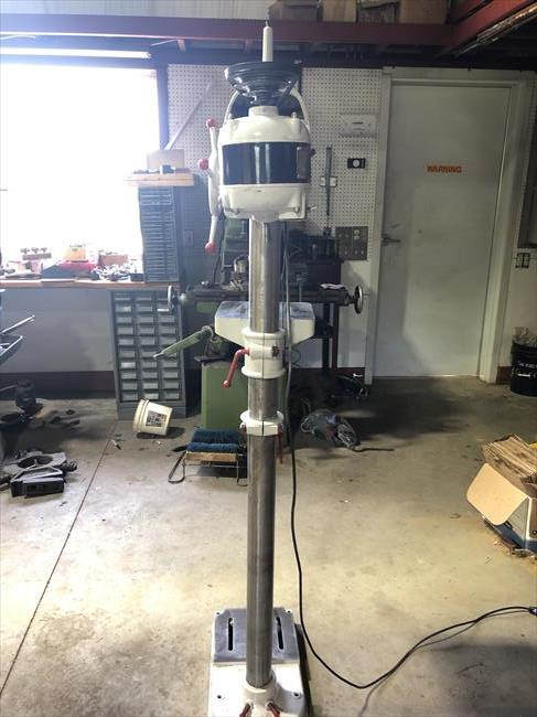

Full Frontal

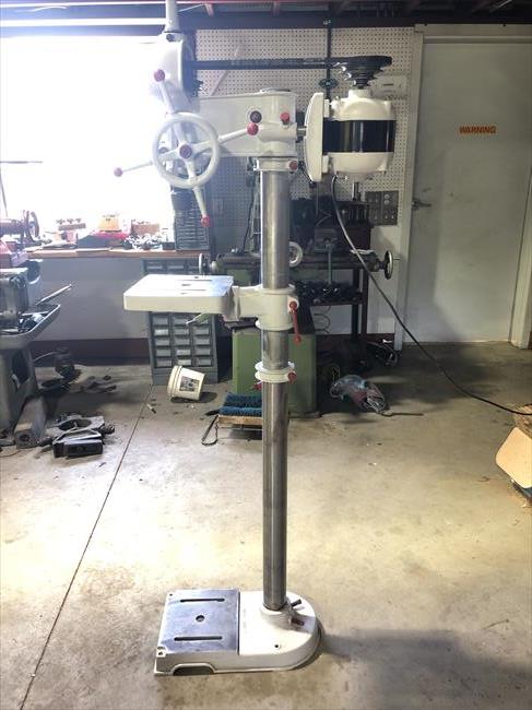

Right side view

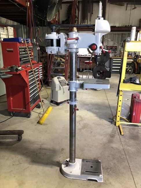

Rear view

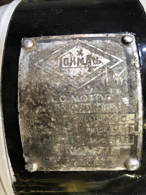

Motor Info

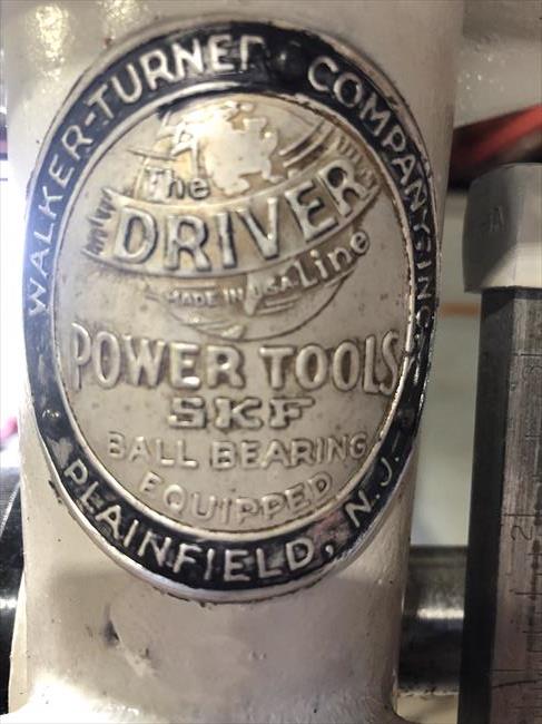

Mfg Badge
