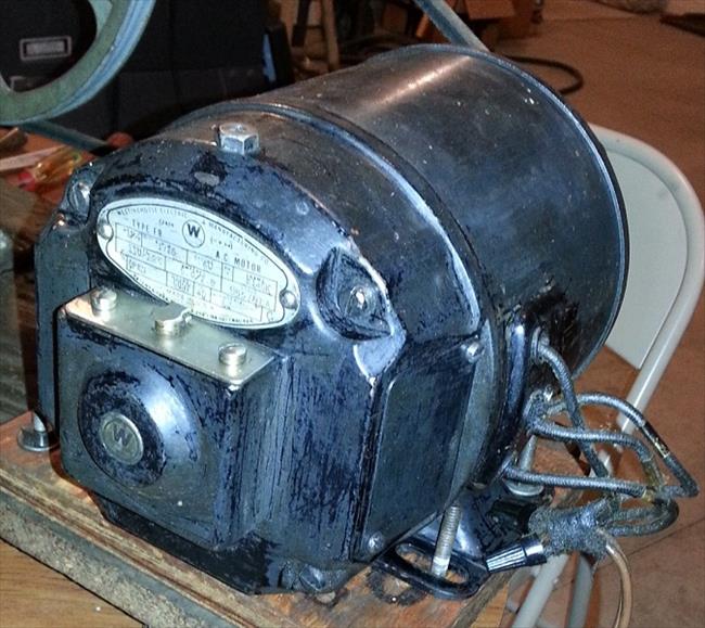

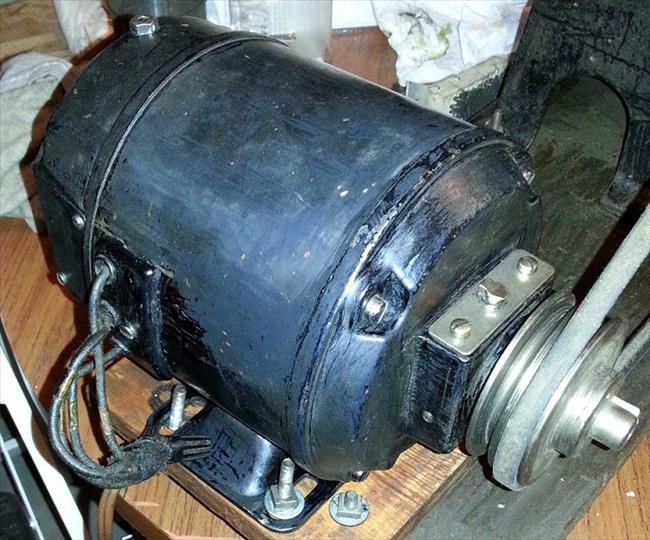

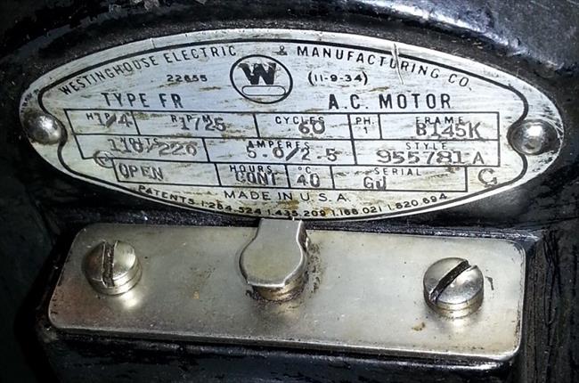

Type FR, Style 955781A, Frame B145K. 1/4 HP, 1725 RPM, 110/220V, 60 Cy, 5.0/2.5 amps. It is a repulsion-induction type. It is powering an old Brunner air compressor that I bought. ID plate includes several patents, latest of which was issued August 1931. ID also includes a marking "(11-9-34)", which may be a date? The "GJ" serial code probably indicates 1938.
view 1

view 2

ID plate

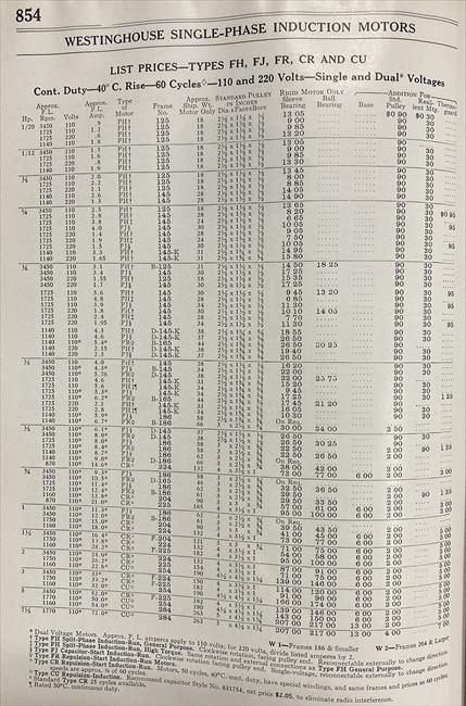

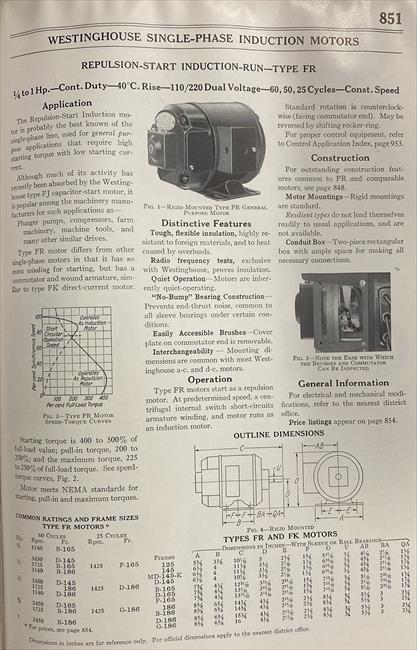

from 1939-40 catalog
