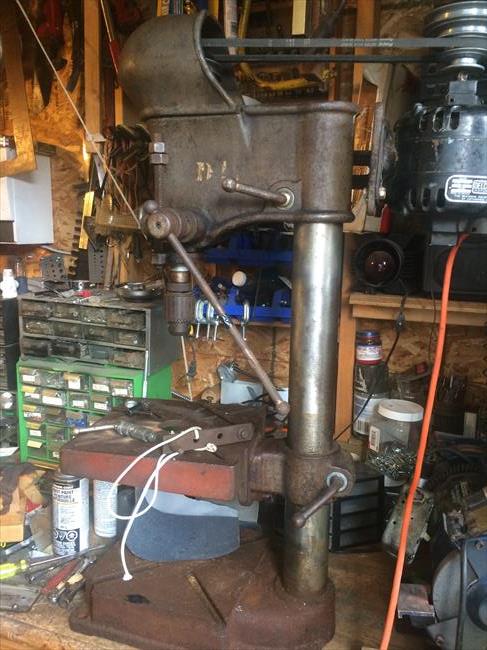

Bought off Kijiji in a sorry state,every thing was seized and motor only worked if laying down took apart and cleaned armature and put back up washer on works great now. Before and after pictures all painted cleaned up,took a big nut cut it in two rounded it off polished it for dept gauge,filled holes in table with aluminum grindings and crazy glue then sanded cheap fix but it worked.
Comments: Front right side
Source: iphone 5s
