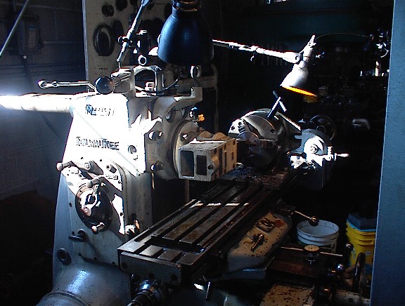

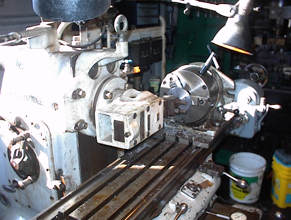

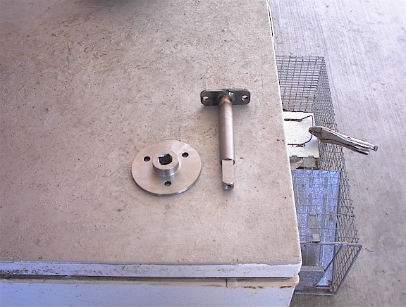

Surplus from the U.S. Navy.. Here it is shown cutting a new drive flange for an International tractor using a slotting attachment.. The part is no longer available from IH... Tool used was ground from hi speed steel to cut a square hole in a steel plate...
cutting square hole in drive plate for tractor hydraulic pump
Slotting head in use cutting square hole in drive plate for hydraulic pump on tractor

New drive flange for tractor hydraulic pump
