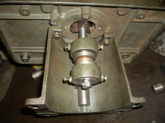

Bought at auction, It had a double ended shaft on it with 1/2" on one end and a 5/16" on the other.had to make a new shaft for it so I did away with the 5/16" and machined a hexagon for a 9/16" wrench to be able to hold the shaft when tightening the nut to hold the cutter, and adapted some hold downs that I had. I don't need it so for now it will go on the shelf
Comments: Front
Comments: back
Comments: Hex
