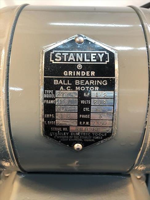

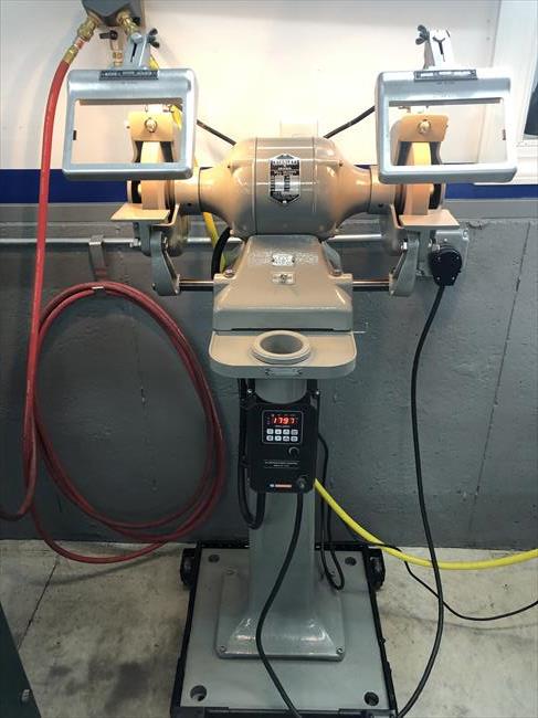

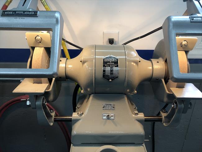

Picked this up from an estate sale. Was in working condition but needed new wheels and cleaned up. Repainted, rewiired, new haredware, added a larger 18x18x1 base for stability. Since it’s three phase, added a motor controller to convert from single to three phase. This allows adjustability via potentiometer and allows for reverse if needed. Also replaced the safety glass for both sides.
